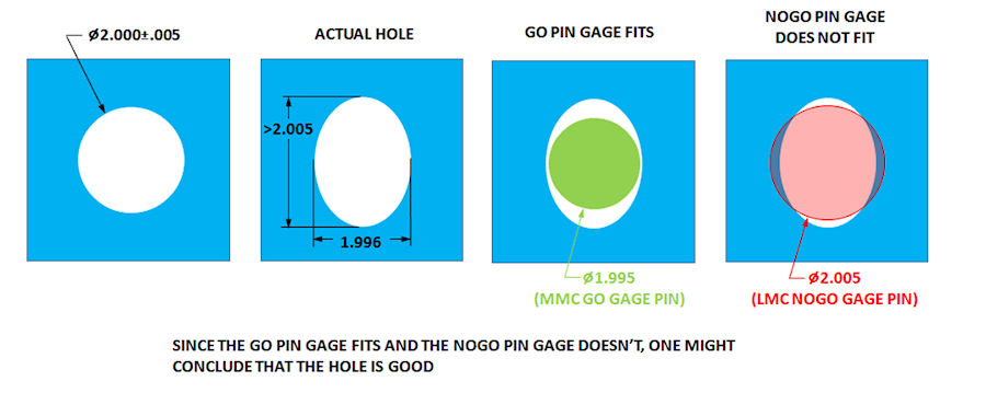

When size is really important, throw away your NOGO pin gages (#12)
According to Rule #1 of the National Standard, the least material size (largest internal feature or smallest external feature) of a feature of size should be verified at each cross section. NOGO pin gages do not detect form errors. If a hole, for instance, is out of round (which they usually are) a NOGO pin will not detect that some cross sections of the hole are actually larger than the size will allow.

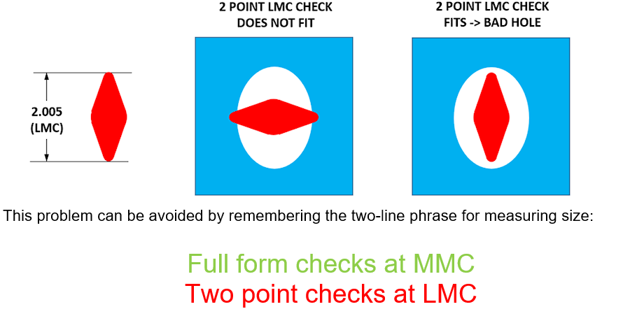

In order to detect that the size is being controlled, two-point measurements must be made. The hole illustrated above would pass a NOGO pin but would fail a two-point check as shown below. In other words, this hole fails a proper inspection of size.
